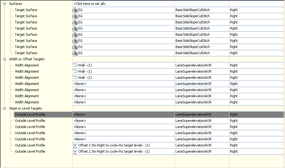

    Thats some frequency :smileywink:
    Have you verified all targets for all regions?

    Thanks, yes, I could reduce the frequency, but it's only 50m long and I wasn't confident with the 1m frequency. I really need to compare surfaces for different frequencies (probably finished contours would do it).
    Yes, but I've not removed all the region definitions and retargeted from scratch. I'm not sure if it's correctly designed or not. Maybe these further screengrabs will be informative.

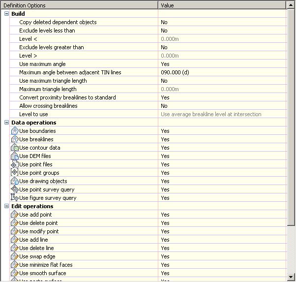

    sboon wrote:
    It looks like you might have a boundary problem that is causing triangles to be deleted.  How is the surface boundary defined?
    The surface is created from the corridor, with no additional edit operations listed in the surface properties.
    (The remaining Edit operations are Yes, except 'Use simplify'.) Some of the missing triangles cross region boundaries, but some are within single regions, with correct triangles either side running to the start/finish of the region(s).

    sboon wrote:
    To clarify my original question.  Is the surface boundary defined in the corridor by polygon, by featurelines or by corridor shrinkwrap?
    The boundary was undefined! I've added it as corridor shrinkwrap and it now seems to be sorted! Thanks so much :smileyhappy:
