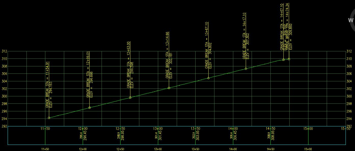

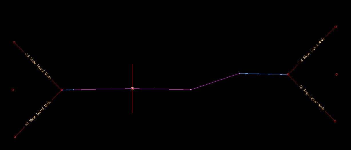

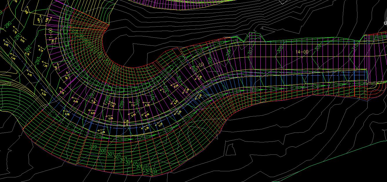

    Yes Peter, I will post the screen caps.  I tried "LinkSlopetoElevation" and that one seems to help.  At least it follows the profile elevation, but there seems to be no way to maintain the 3' min offset as seen towards the end of the alignment (see plan shot).
    When I use the "LinkSlopetoElevation" SA and give it a negative slope, it still appears in the assembly to slope upwards.  It still works, it just looks odd (last pic).

    Valued Contributor
    david.dixon
    Posts: 71
    Registered: ‎11-13-2006
    Re: Corridor Modeling Question
    09-01-2011 06:48 AM in reply to: david.dixon
    Please use plain text.
    Valued Contributor
    david.dixon
    Posts: 71
