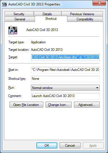

    If the former, then this problem seems to be innocuous, just a tad annoying.  You can just hit "OK" and ignore it.
    If you want to do a reinstall, that that depends on how you have C3D setup.  Of course, if you do a "full wipe and reinstall", then you WILL destroy your setup.  If you plan on doing this, then you may want to save your current user profile (in OPTIONS -> Profiles tab) to a .ARG file, then reload it after the re-install (with the caveat that, if your problem was in your user profile, you may re-load the original problem when you reload the .ARG file, and you're back to square one).
    You will also destroy your setup, even when installing a Service Pack, if you are using the "<<Unnamed Profile>>", the "<<C3D_Imperial>>" profile, or the "<<C3D_Metric>>" profile.
    So what I recommend is that, when you first install C3D, create a new profile, as seen in this image:
    Essentially, I had my "favorite" profile set current (either Imperial or Metric), then I selected "Add To List" and created my C3D2013 profile.  NOW I configure the profile the way I want.  (And I can also always save this to a .ARG file when I'm done, just in case, so I don't have to repeat work if I get into trouble later.)  This new C3D2013 profile will NOT get "clobbered" when I install a service pack, and I don't have to save out and reimport my settings (or go through the arduous task of re-setting everything, if I forget about this issue).
    The only final thing to remember is to edit my C3D startup shortcuts, so they now call my "C3D2013" profile, as shown in this image:
    I'm now "clobber-free", and can install service packs or do repairs without losing my settings.

    The User Profile mostly just stores the options you set in the OPTIONS tab.
    But there's a bit more to it...  BE CAREFUL, but open up REGEDIT and look around in a key like:
    HKEY_CURRENT_USER\Software\Autodesk\AutoCAD\R19.0\ACAD-B000:409\Profiles
    (Replace the release number with the current version of your software...  R19.0 is C3D 2013, R18.2 is C3D 2012, etc.)
    Compare the C3D profiles with the default "AutoCAD" profile.  A key thing about a valid C3D user profile is that it includes "IsPureAcadProfile" set to 0, while the "AutoCAD" profile is set to 1.  There are also FAR more subkeys in that profile for a C3D profile.
    If you don't start with a default user profile like "<<C3D_Imperial>>" or "<<C3D_Metric>>", then you'll be missing most of these keys.  That's why such profiles don't work correctly.  So ALWAYS make sure you start with a default C3D profile, and make a copy of it, THEN customize your copy.  (Autodesk really should fix this problem, so that any profile created by C3D is created correctly.  As it is, if you don't start by copying a default C3D profile, you'll get something that looks like the core AutoCAD profile, and many C3D functions won't work.)
    Again, be VERY careful when poking around in REGEDIT...  You can break things easily if you do the wrong thing.  But as long as you just look around without changing anything, you should be fine.
