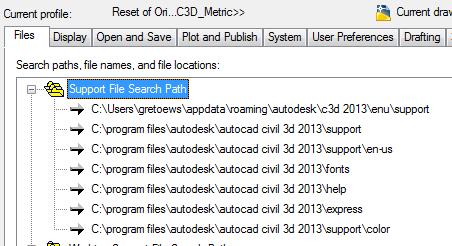

    neilyj wrote:
    I reset the C3D_UKIE profile in Options > Profiles and all seems ok again.....so far
    Sorry for such a lengthy post but I'm not sure Reset should be used with a vertical product and here is why.
    I don't believe AutoCAD/Civil3D has any functionality built in to reset a profile to a shipping vertical product profile. How would you know what you are resetting to, Civil 3D comes with quite a few profiles? Hoping that it resets a profile to a shipping profile of the same name is a bit of a stretch IMHO.
    Likewise the "Set Current" button really is a bit of a misnamed button in a vertical product because the shortcut you use to start Civil 3D specifices a specific profile indepentdant of what you may have previously "Set Current".
    I have a profile called "<<C3D_Metric> Default" which I renamed from an uncustomized "<<C3D_Metic>>" after running Civil 3D for the first time. I have an exported custom profile ARG file that I import and rename to <<C3D_Metric>> so when I run Civil 3D from the default metric shortcut I get the our custom profile.
    So if I take "<<C3D_Metric> Default" and make a copy of it to "Copy of Original <<C3D_Metric>>" and then export both I should get the same ARG file (except for the profile name) right? It is close but the following keys are missing. The keys are empty so not a huge deal assuming Civil 3D will recreate them as needed but it shows there is not a lot of attention to detail in this area.
    [HKEY_CURRENT_USER\Software\Autodesk\AutoCAD\R19.0\ACAD-B000:409\Profiles\<<C3D_Metric>> Default\Dialogs\CustomizeDialog\TabExtensions]
    [HKEY_CURRENT_USER\Software\Autodesk\AutoCAD\R19.0\ACAD-B000:409\Profiles\<<C3D_Metric>> Default\StatusBar]
    Now if I take "Copy of Original <<C3D_Metric>>" and make another copy to "Reset of Original <<C3D_Metric>>", reset THAT profile, and then export it to an ARG and compare then the fun really begins.
    Copy of Original:
    [HKEY_CURRENT_USER\Software\Autodesk\AutoCAD\R19.0\ACAD-B000:409\Profiles\Copy of Original <<C3D_Metric>>\Defaults\AecBase70]
    Reset of Copy of Original:
    [HKEY_CURRENT_USER\Software\Autodesk\AutoCAD\R19.0\ACAD-B000:409\Profiles\Reset of Original <<C3D_Metric>>\<<C3D_Metric>>\Defaults\AecBase70]
    So you can see that the registry key path has an extra key in there named "<<C3D_Metric>>" which I pretty sure means Civil 3D can't read it.
    Also, if I look at my workspace list all I have is the default AutoCAD workspaces, no Civil 3D workspace, no Civil 3D ribbon tabs.
    At this point I think all I'm getting is mostly just AutoCAD, a little bit of Civil 3D, and a lot of missing settings (the 'reset' ARG file has lost 15% of its content).
    Here is a typical support path for Civil 3D:
    Here is what I get after resetting the profile (looks a lot like vanilla AutoCAD to me):

    Distinguished Mentor
    Posts: 839
    Registered: ‎09-07-2004
    Re: C3D 2013 Hotfix 2 released
    09-10-2012 10:37 AM in reply to: johnfraser
    You may want to check your support file search path and at least add in the last three folders which may be missing.

    *Expert Elite*
    neilyj
    Posts: 2,696
    Registered: ‎08-01-2008
    09-10-2012 11:37 AM in reply to: GTVic
    All seem to be present and correct....
