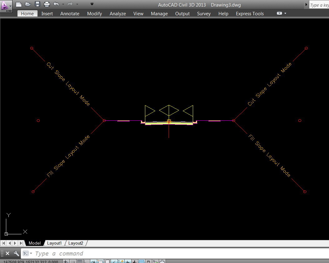

    “Basic assembly” is not drawn correctly in the section view,
    In the screenshot below, the “Basic assembly” is not drawn correctly in relation to the existing ground.
    What might be the reason that it is not closed with the existing ground?

    To me it looks like a target isn't set properly in your Corridor Properties. Either that or there is a gap in your surface which it doesn't look like is the problem.

    Your surface isn't wide enough at that station.  You're using, say, a 3:1 slope and that slope will not intersect the surface because there is not enough surface.
