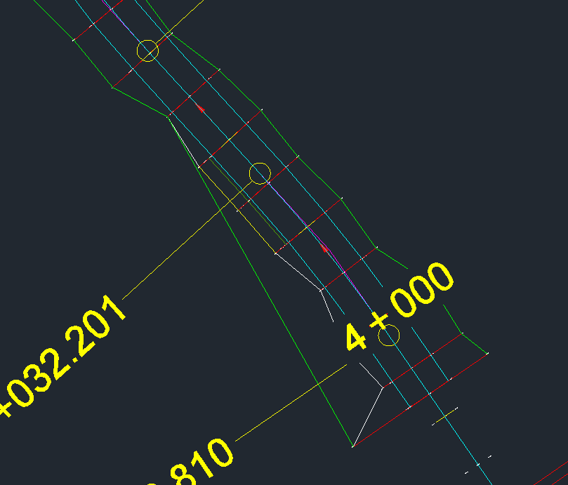

    I have a road corridor with feature lines connecting the road edges (cyan), ditchline (dark green), daylight_cut (yellow), daylight_fill (green) and daylight (white).  At certain random locations along this corridor I am getting feature lines which span from one station to another, ignoring all of the corridor sections in between.  The image below shows a daylight_fill line spanning over 60m, even though there is a daylight line through this region.
    In this area a ditch line and a daylight_cut start at 4+110, skip over the next cut section at 4+120 and jump over a hundred meters to the next piece of ditch at 4+280
    This corridor builds clean - no error messages reported.  Is anybody else seeing this behaviour?

    Can you post the dwg? or a sample dwg?

    In the Feature Lines tab of corridor properties...Does Branching Inward or Outward make a difference?

    Nope.

    I know that you have probably checked this... but just looking at your screen capture, I have to ask.
    Is there a corridor surface in your dwg with the border only display on?

    To answer your previous question...Yes, I saw this a few times...branching outward solved it for me a couple times.

    No surface Dana.  The green lines are Daylight_Fill feature lines, the yellow ones are Daylight_Cut, and the white ones are Daylight codes.  The darker green ones parallel to the Daylight_Cut  are the Ditch codes.

    Was the assembly built in 2013?...have had problems mixing subassemblies from different versions of software.
