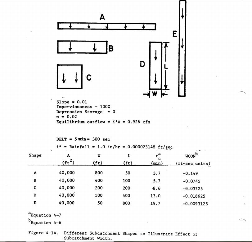

This is not correct in the SSA help. The basin Width drains to the outlet channel.
The Width should be parallel to the outlet channel. The Length should be the distance down to the outlet channel.

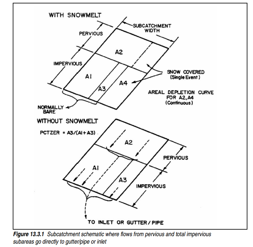

No, you're making the mistake in that diagram of including the gutter as a component of the idealized subcatchment runoff calculation parameters. Below is what you should be using.
An initial estimate of the characteristic width is given by the subcatchment area divided by the average maximum overland flow length. The maximum overland flow length is the length of the flow path from the the furthest drainage point of the subcatchment before the flow becomes channelized.
The idealized subcatchment in SWMM is simply a non-linear reservoir model.

I think what you are expecting is something that represents the single flow plane like the following which is in the original BOSS StormNET Techincal Reference with the original source being the EPA SWMM manual image.
I have no problem having the Equivalent Width descriptions re-arranged for clarity.

fcernst
in reply to: Matt.Anderson
Hey Matt,
I like this one from your reference for demonstrating the SWMM flow width parameter.... A, B and C are good... and D&E are unacceptable (channelization would occur prior to these lengths).
I think the second image, of section view, I show from SWMM 5 is very important to grasp for the subcatchment computation conceptualization...
