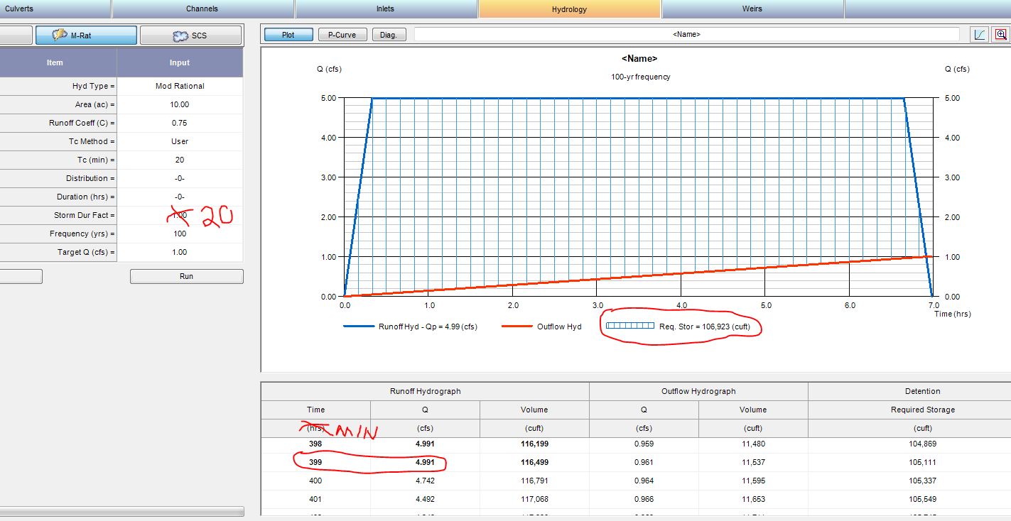

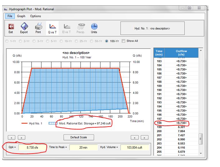

Yes, I don't know why it is doing that. You should be able to take it out further, to the critical duration,  to get your max required storage.
Consider the two calculations I ran with identical basin parameters: A = 10 ac, C = 0.75, Tc = 20 min, Qtarget = 1.0 cfs below:
I ran one in Hydraflow Hydragraphs shown first below, the second was in Hydraflow Express, shown below that.
  • Hydragraphs went out to SDF = 9.9, and came up with 97,245 cf of estimated storage.
  • Express took it out to SDF = 20, and came up with 106,923 cf of estimated storage.
  • Modified FAA Method software I use, came up with 126,069 cf of estimated storage.
Hydraflow Express has a couple of display issues going on also:
  1. It doesn't display the SDF past 9.9, it goes back to displaying 1.0, however it takes the computations out further to the critical duration, as can be seen in the graph and table.
  2. It displays minutes in the table but the column heading says "hrs".
  • It would help Hydraflow to report a little more estimated storage, if it used the typical Modified Rational Method Receding Limb duration of 1.5xTc, instead of just 1xTc as it does now.
Fred Ernst, PE
