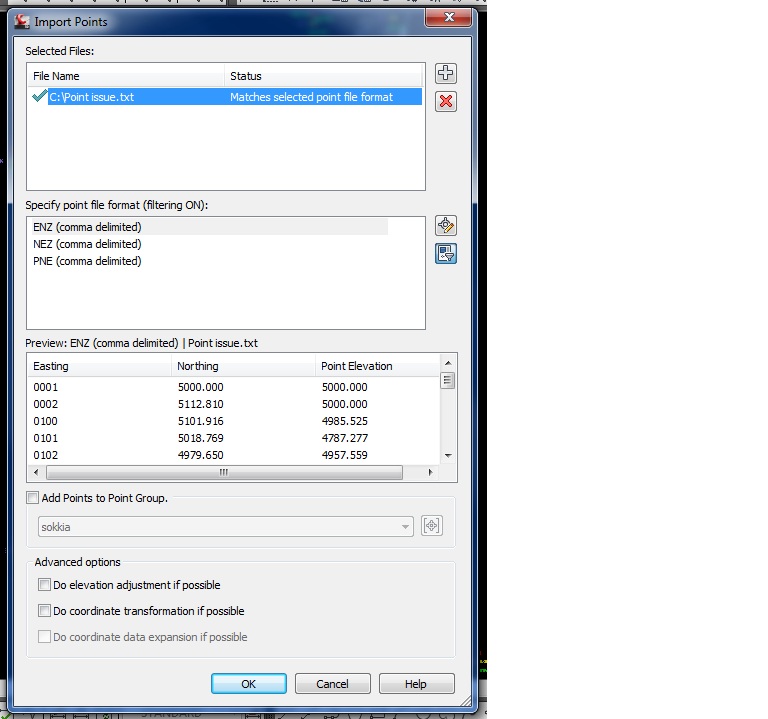

New to Civil3D 2012, so please bear with me.
I have a point file with <null> elevations. Somehow it won't let me import this .txt file (using pnezd comma delimited) into my .dwg. If I have elevations I have no problems. We tried creating a pned (comma delimited) and the <null> having an unused column and it didn't work.
Ideas? Thanks in advance.

in reply to: AllenJessup
Message 10 of 35
in reply to: Anonymous
I also attached why I see when trying to import points. Note that the pnezd comma delimited option does not show and when I try to add it, it tells me it is an invalid format.
Thanks.
This is how it should look:
I notice you have filtering on. I don't know if that's blocking the PNEZD format. Try turning it off.
Message 16 of 35
AllenJessup
That looks like it. Do the points come into the drawing OK?
Allen

Ok, we are getting somewhere here. I turned the filtering off. I replaced the <null> for "0". Imported my points but the descriptions are not coming in. (I tried the .cvs part but I normally just grab the point file, not really export them when it comes from the field).

Jeff_M
You could just create a copy of the PNEZD(comma delimited) point file format and edit it so the elevation column is unused.
