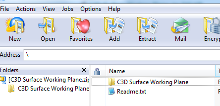

Excellent - many thanks Jeff.....although a couple of comments....
1. I couldn't see the readme file in the zip
2. When using the commands and being prompted for the first point it isn't clear that it must be a "proper" point e.g. Civil Point (this may be in the readme though). Would it be a great hassle to modify the code such that for the first point the user can also pick any XY location and be prompted for the level (or surface from which to obtain the level)??
3. Presumably these commands can be added to a toolbar/pallete etc in the usual way??

1. The readme is iin the zip, at the root level:

1. I just unzipped the zip and couldn't find the readme as it was in the root - but ok now and the commands make more sense after reading it..Smiley Happy
