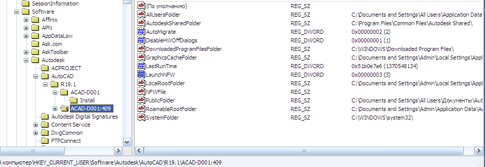

To confirm, you are talking about this, right?
maxim_k
I believe it is LaunchNFW key. In order to disable Welcome screen you need to set it to 3
