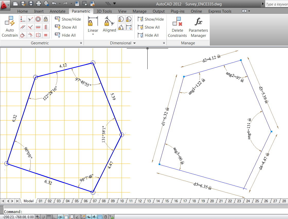

    JamaL9722060
    Posts: 1,121
    Registered: ‎04-09-2010
    Re: What is the most efficient way to draw a line inclined by
    04-20-2012 01:29 AM in reply to: rkmcswain
    I’m again struggling with another issue!
    I wanted to sketch up the polygon (existing) shown in the screenshot below, but couldn’t figure out the best way to approach it. This time:
    1. The given angle is the interior,
    2. The angle is given in deg/min/sec
    How can I draw such given polygon efficiently?
    Many thanks
    Best

    *Expert Elite*
    Posts: 6,460
    Registered: ‎06-29-2007
    04-20-2012 01:37 AM in reply to: JamaL9722060
    do first a sketch of the figure and then place the contraints for distance and angle.
    What I have not tried now is if you can input the angle-value like you show the angular dimension with ° ' "
    - alfred -

    JamaL9722060
    Posts: 1,121
    04-20-2012 02:02 AM in reply to: alfred.neswadba
    Brilliant Alfred. This is a quite satisfactory solution.
    As you have already indiacted, what is missing is to represent the angle in deg/min/sec
    Many thanks

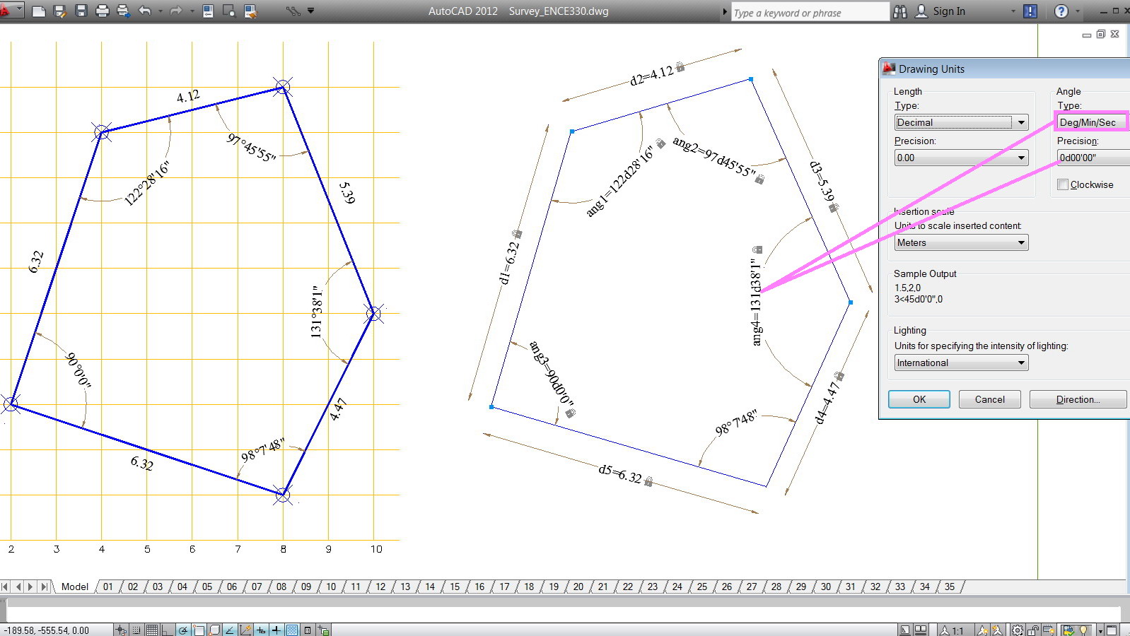

    JamaL9722060
    Posts: 1,121
    04-23-2012 04:08 PM in reply to: alfred.neswadba
    Hi Alfred,
    A colleague indicated that changing the drawing units will solve this issue.
    Please, have a look on the screenshot below
    Best
