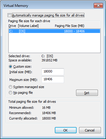

    When I see that error I find it's typically a Windows setting and not AutoCAD.  Check your virtual memory manager, I suggest one of two options.  If you have a fixed number set for virtual memory, increase that number.  If you don't want to guess, select the option to have Windows manage the virtual memory for you.  This has generally solved all my memory issues.

    Thanks for posting. Unfortunatly my virtual memory settings seem to be set properly.
