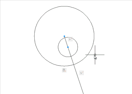

    I want to find the tangent intersection point between 2 circles within certain conditions.
    Circle 1 is r: 30 m and is fixed.
    Circle 2 is r: 20 m and its position is inside circle 1.
    Circle 2 can be moved in a given angle.
    The question is: what distance should circle 2 move, to become tangent with circle 1.

    Programmatically or drawing?

    you can solve that with constraints, look here:
    And a drawing is attached also.

    kansoms,
    if it is drawing,
    all you need is to do an offset of outer circle with de distance of the radius of the inner circle the
    point of intersection between the further circle and the vector of displacement is the center point of
    the tangent circle.
    hope that helps
    Henrique

    This is wat I was looking for. Why dydn't I think of it???
