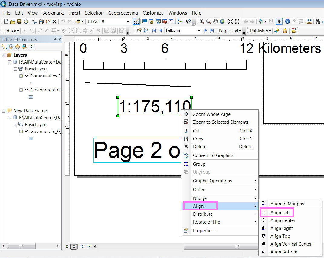

    How to align texts in the AutoCAD?
    I’m wondering if there is a way to align texts in the AutoCAD with no work around. For example, in the ArcGIS we can select the texts and force the alignment.
    Sure, in the AutoCAD, I can force the text to have the same x-coordinate to align them or other kind of work around, but why we don’t have this as a command like what we have in the ArcGIS?
    I don't see why setting of the "Position X" should be named as workaround, it is straight to use. :smileywink:
    But to answer the primary question: no, there is no built in command for that. If you need it daily, you can look for a tool that does it or write one. This option is always available with AutoCAD!
    Because there where/are different people/different companies developing it for different jobjs to be done. And if I'm working in CAD, I want to have a text on an exact place (exact coordinates) and not on an coordinate where some tool means it should be "arranged to".
    Other question: Try in ArcGIS to label a network-topology (e.g. lines of streets), so the labels follow the GIS-arcs .... and now try to arrange these labels ==> you also can't do that. :smileywink:
    There is functionality in AutoCAD, there is functionality in ArcGIS, and if you are asking why a car can't fly and why an aeroplane can't drive curves as fast as cars can .... they are different, what shells, they are built to do their work ... and their work is different.
    Sorry, - alfred -

    So you are drawing lines to represent boxes, and adding floating text objects inside them (if your posted image is like the last actual DWG file you posted): so it begs the question, why aren't you using a TABLE object in AutoCAD? It does what you seek inherently unless you actively mess with the settings for each cell in the TABLE. And that's not a workaround, that's a totally different command and approach than LINE and TEXT and all that eye-balling.
