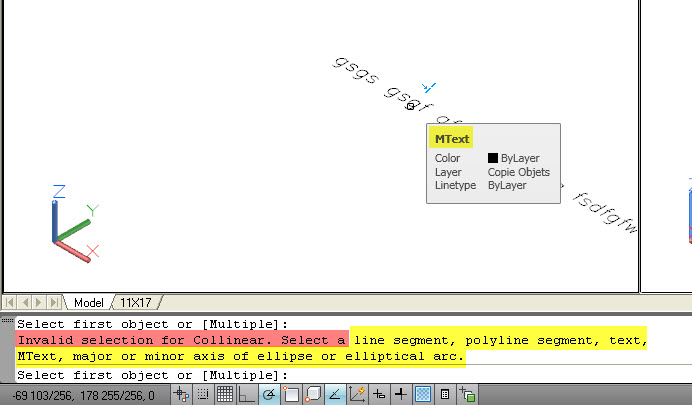

    I have had the exact same issue so I stopped hoping that constraints would work on mtext! Lets see if 2012 will have that issue corrected. See the print screen for what it does to me when I try to manually apply constraint to an mtext:

    Hi nestly,
    I tried all ways around, changed all my variables related to texts, mtexts and parametrics looking forward to find the good combination. Even when service pack arrived I tried over and over again and it is still not working on my side.
    Would you mind post a sample cad file with working constrained Mtext? What are the exacts steps you use?
