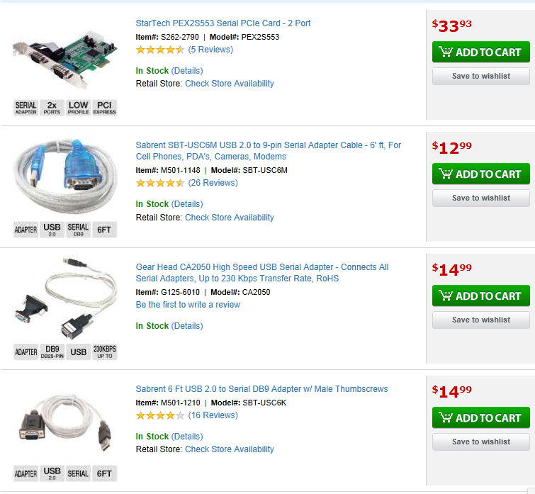

    hardware lock problem
    11-20-2012 10:04 PM in reply to: jdoverman
    i have seven autocadd 2000 and 15 autdocad R14.. the problem is i cant use this software from a new pc available in the market.. because ther is no lpt1 port availabe in a new motherboard is their any other way to fix this matter
    thank you

    Re: hardware lock problem
    11-21-2012 05:32 AM in reply to: wrqnavy07
    Would either one of these work?  This came from Tiger Direct.

    Re: to wrqnavy07 hardware lock problem
    12-16-2012 04:37 PM in reply to: wrqnavy07
    " because ther is no lpt1 port availabe in a new motherboard is their any other way to fix this matter "
    Thery big number of new motherboards (Check with you local hardware providers) from "Intel" (DH77KC, DH77EB), "ASUS" and "Gigabyte"  (GA-H77M-D3H, GA-H77M-D3H) with last chipsets have onboard Parallel Port (via Internal Header). But not have external connector (LPT bracket 26pin to 25pin).
    You need one like this from the list
    http://www.ebay.com/sch/i.html?_odkw=LPT+connector&_sop=15&_osacat=31491&_from=R40&_trksid=p2045573....
    for each motherboard.
    Simple install in Windows XP 32bit and Windows 7 32bit.
    Need only run in compatibility with Windows 2000 and "run as administrator" in Windows 7
    You need update hardware lock (plug) driver for Sentinel from new support site: http://c3.safenet-inc.com/display_results_google.asp?DocId=19141
    In Windows 7 64bit and Windows 8 64bit - need more "tricks". Replace setup.exe (for 32bit program this file build as 16bit application) with this http://toastytech.com/files/Is3Engine.zip. Also run in compatibility with Windows 98 (Windows 8 not have option for Windows 2000) and "run as administrator". But You not have option to install serivis pack and express update. After first installation need only copy all AutoCAD folder and Autodesk Shared from another, updated, XP computer or installed in XP mode, Virtual PC or VMWare mashine.
    This Intel Workstation board include Back Panel LPT connector:
    http://ark.intel.com/products/59043/Intel-Desktop-Board-DB75EN
    This Gigabyte boards also have Back Panel LPT Connectors
    http://www.gigabyte.us/products/comparison/list.aspx?ck=2&pids=4152,4151,4195
